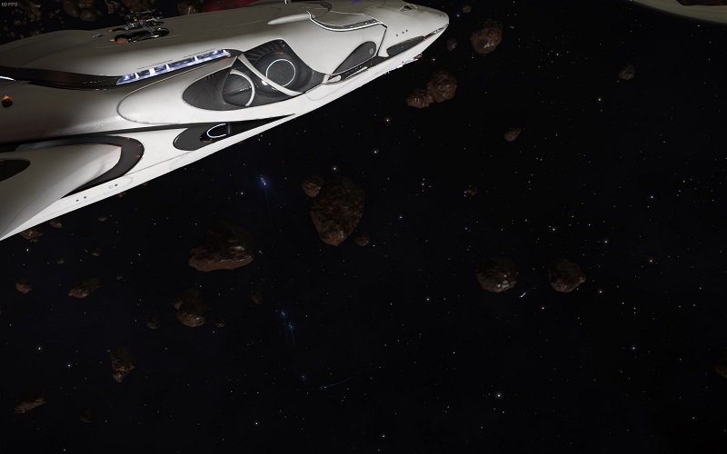

Pan vysavač v akci :D
http://coriolis.io/outfit/imperial_cutter/08A8B7A7A7A7A6C2c161628282m2m04040404020303000707054fCeCePe1v24.Iw18ZZA=.Aw18ZoIxA===
Vysavačmalá.jpg [ 68.82 KiB | Zobrazeno 9627 krát ]
